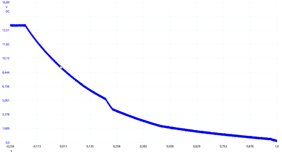

  • Hello Wyatt,
    ok, found it in the hardware DS:
    So the voltage on the pack pin should be below 1.8V to definitely be able to enter shutdown and above 2,45V to leave it.
    >> The gauge will shutoff the DSG FET when it attempts to enter shutdown, so the voltage should drop at that point.
    Thanks for the good info so far! Slight smile
    To find out more about the pack voltage behavior I can simulate the battery trying to enter shutdown by manually turning of the DSG FET and measuring the voltage across pack+/-. I can see it dropping to < 10mV in an instant (did not measure with a scope yet). But what's the required speed? I.e. how long will the gauge wait after it turned DSGFET off until it tries to enter shutdown?
    Would you agree that to see whats really happening on the pack pin I'd have to crack open the battery casing and measure directly between the pack pin and VSS (device ground)? Or would you consider measuring between pack+/- as sufficient?
    Sebastian
  • Hello Sebastian,
    From reviewing the schematic I don't think there would be a large difference between PACK pin and the pack+/pack- port since it's only got 10k ohm in the path and no capacitors on the PACK pin node. I would put a scope on it just to make sure everything looks okay.
    Sincerely,
    Wyatt Keller
  • Hello Wyatt,
    for reference I had a look at the pack voltage of a battery that did not have the shutdown problem yet. One graph is the moment of shutdown and the other ist when turning of the DSG FET manually. They seem alright to me, but I don't know the required timing constraints anyway.
    Pack voltage in the moment of the shutdown takes ca. 0.55s to reach 1.8V
    Pack voltage when turning off the DSG FET manually takes 630ms to reach 1.8V
    I will make the same measurements when I get my hands on batteries which are known to show the shutdown problem.

  • Hello Sebastian,
    No problem, when you post on the thread again it will open it on our side.
    I don't believe that time period would be an issue to wakeup the gauge, it would be interesting to see packs that are having trouble and if the time delay is much longer.
