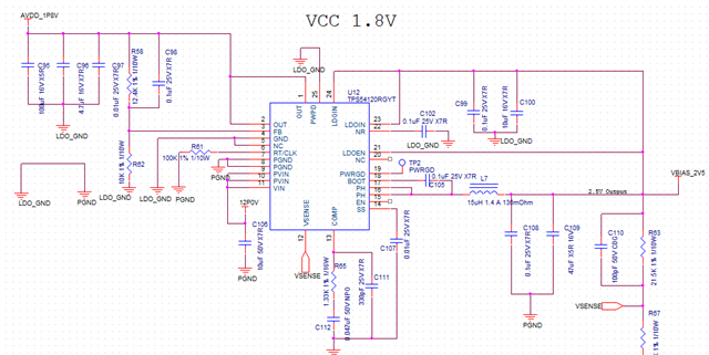

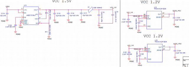

I have a design where i was using TPS79901DDCR for generating 1.2V for ADC from 1.5V
the 1.5v dcdc takes directly 12v rail as input, which is beyond limit of VBIAS
can i take VBIAS from alternative rail ? kindly let me know will there be any issues with this kind of approach
my 2.5v bias voltage is coming from rail of dcdc shown below, which is a dcdc output that is being used for generating 1.8V for dcdc.

    I see here in your schematic that you are using the TPS7A14, not the TPS799, the TPS799 does not have a bias rail so I think I am looking at the correct part in the TPS7A14, correct me if I am wrong,
    12V rail for the Bias is too high for this particular device, the in recommended operating condtiion is the larger of 2.2V or Vout +1.4V, you would need 2.6V on your Bias rail as a minimum and 5.5V as a maximum.
    In your current configuration your VBIAS is 100mV below recommended for operation, is there any way that you could step that higher, or if you have a rail between 2.6V - 5.5V?
    John
  • Thanks verymuch i did not see in detail about the point in datasheet "Greater of 2.2 or VOUT(NOM) + 1.4"
    I have a 5V rail used for alterantive purpose, i used it for bias voltage.
    I hope a alternative rail independent of input is ok to be used, thanks.
  • Hi Shyam,
    Yes, Bias rail is encouraged to be a separate rail from the input rail, utilizing the 5V rail will be sufficient to allow the part to operate correctly.
