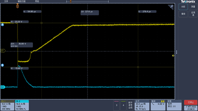

  • For Q1:
           channel 1: VDS       channel 2:  I_24V
    channel 1: Vout-GND      channel2:  I_ds
    These are the test picture. We added a TVS between Drain and Source the IC work well under the -1100V Surge. So please help me double confirm whether the IC energy exceeds the maximum, especially for the FET current.

  • Hi Hao,
    The second picture is too small to read. Could you get a clearer picture? Also could you ask customer to probe the VDS and Ids on the same scopeshot?
    One question:
    From the first picture, the max VDS is only 38V. From the original post, it says that "When we powered the VS 23V and used a TVS to clamp the -1.1kV surge voltage to -40V, but the IC was broken.". Did you mean 23V at VS and -40V at VOUT, which means 63V for VDS? Which one is the correct value? 38V or 63V?

  • Hi everyone,
    The customer means 23V at VS and -40V at VOUT, which means 63V for VDS.
