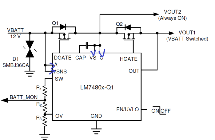

LM7480-Q1: pin leakage evaluation
Part Number: LM7480-Q1
Dear team,
What is the leakage current of the 4 pins shown under below conditions?
1. EN=0;
2. VSNS is OFF
3. SW is OFF
4. Hgate is off.
Thanks & Best Regards,
Sherry
  • Hi Sherry,
    We only have information on the total/sum of currents flowing into all the pins of the IC which is = the current flowing out of the GND pin.
    When the device is
    • Enabled (EN=HIGH), the Max current drawn by all the pins of the IC = 495uA
    • Disabled (EN=LOW), the Max current drawn by all the pins of the IC = 5uA
