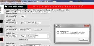

  • well I did find slcu157 so have profiles for more than our expected 20z45R1 (v1.05). starting bqEVSW gives me a choice of that and 20z45 with v0.02, v1.00,v1.01,v1.03,v1.04  None of them are working for us. All give "No communication with EVM Gas gauge could be established. Please check connnections."......yadah, yadah.    Swapping out for a known good pack with the expected gauge and all is good. We see the programming tab at the bottom of the Pro screen. We will need more help in accessing these parts we received as they are not giving up easily their current state. We will need the .SENC file please.  Have not heard a bit from Connor. ................................Oh, I find him in the an alternate folder.  in contact now....
  • Hello Ken,

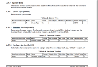

    Please share screenshots with the errors you see. The installer I sent should work for that gauge (BQ20Z45), if it is not working there may be an issue with the gauge you are communicating with or the hardware. Have you verified it's not in shutdown mode or powered off? REG25 should have voltage if the device is powered and not in shutdown. Also double check the hardware connections to the EV2400 module.
    Also I need to know the build and version number of your previous parts in order to share the .senc file with Connor.
    The firmware version command is in the TRM A.1.1.2 Firmware Version (0x0002).

    What is TRM A.1.1.2 Firmware Version (0x0002) ?
    Does it matter which of these builds I try first? (tried them all and none work)
    finally the word write does nothing either:

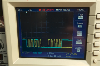

    clock and data are wiggling.
    TRM:
     ok yes , if only the chips would respond to ANY commands.  They do not.

  • Hello Ken,
    It looks like the gauge is not communicating at all, the most common reasons for this is the gauge going to shutdown, it's not powered, or there's a hardware connection issue. It should detect the gauge if it is communicating. Make sure you are applying voltage on the pack+/pack- pins to keep the gauge awake if it is trying to shutdown.
    Even if you have the wrong version you should be able to read data from the part with the pro tab.
    TRM = Technical Reference Manual, it is linked on the parts product page and defines all the registers and operation. The section for the command to read the version is:  A.1.1.2 Firmware Version (0x0002)
