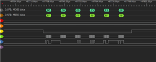

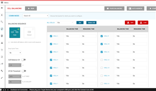

I am using auto cell balancing. I have a 11 cell battery module as the cell voltage source. All cells measure about the same voltage, in the ballpark of 3.37V. I have a BQ79600 EVM and a custom BQ79616, and a BQ GUI/USB2ANY.

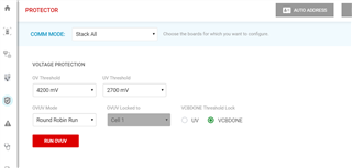

I have attached the BQ GUI settings in the two pictures. I first run the OVUV protector. I have set UV as 2.7V, OV as 4.2V. I can click on VCBDONE but where do I enter a threshold for VCBDONE? I am able to set balance timers and auto cell balancing finishes based on the timers.
In the BQ firmware, I am following the sequence recommended by the datasheet to start cell balancing. I find that cell balancing runs (using a real battery module) only if I don't program the VCB_DONE threshold register. If I have this programmed, cell balancing comes to an stop right away, balstat reads 0x01. Why is this?
Previously, I was manually checking cell balancing with a cell simulator. I set one cell to 3.6V, the rest to 3.5V. I set VCB_DONE_THRESH= 3.5V. Manually I reduced the voltage of 3.6V to 3.5V and confirmed that a breakpoint halts in the firmware to show cell balancing is complete.
I need to understand if it is possible to use VCB_DONE_THRESH with auto cell balancing.

    You can configure the VCB_DONE_THRESH in 'Register map' page in GUI.
    In the firmware you shared, I don't see you are configuring OV_THRESH or UV_THRESH registers, can you please try writing these threshold values from your firmware, also can you please share what value u are writing to VCB_DONE_THRESH. If you can share the logic analyzer logs with the sequence of commands you are sending ( including cell voltages values before and after cell balancing ), it will be helpful.
    Ravi

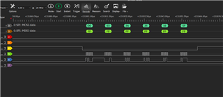

  • The registers are being setup as programmed. I am setting values for UV/OV thresh soon after auto addressing. Logs, pictures are attached. I don't yet understand why cell balancing halts right away if I use the VCB_DONE_THRESH in my BQ firmware. I will go back to the GUI to see what I find.

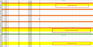

  • The other thing that occurred to me is the vcb_done_threshold register has a 25 mV resolution. The cell voltages are measuring about 3.367V. I changed the voltage balance target to at least 50 mV below this, 3.3V. The BQ firmware I have is still showing balstat is 1 right after balancing command is given, no balance timers begin.
  • Hi Priya,
    You are configuring 'OVUV_CTRL' ( 0x032C ) with value '0x5', so 'VCBDONE_THR_LOCK" bit is disabled, so i see the OVUV comparator is not using 'VCB_DONE_THRESH' for cell balancing. Can you please try enabling this bit.
    Also from the logs you shared, i see after the  'VCB_DONE_THRESH' value is set and then 'BAL_GO' is enabled, after that i see the cell balancing is still running ( CB_RUN is '1' ).
    Also I notice some of the  VCELL first read value is less than the second time read VCELL value. Also none of the cell voltage is greater than OV threshold value 4.2 V or less than UV threshold value of  2.7 V.
    First VCELL value:      15 01 0572 44F9 4502 4503 4507 4506 44FD 44FE 4506 4500 44FE 44FD 4896
    Second VCELL value: 15 01 0572 44FC 44D1 4532 44DA 4530 44D2 4529 44DF 4522 44DA 4502 4CDD
    Ravi
  • Thank you for the correct OVUV setting. Looking at the saved MISO data, there is one value of balstat=8 which soon after becomes 1 showing cell balancing is complete. The cell voltage readings are decreasing. For some reason, the firmware right away halts at CB complete. Currently, I am only reading balstat and no other status registers for cell balancing. I will keep looking at why the firmware is not processing balstat = 8.
  • In the OVUV_CTRL register, I am seeing the lock bit described as follows:
    VCBDONE_THR_LOCK = As the UV comparator is switching between UV threshold and VCBDONE threshold to measure the UV DAC or the VCBDONE DAC result for diagnostics, the UV comparator has to lock onto only one threshold before starting the AUX ADC measurement. This bit selects which threshold is locked to the UV comparator. The bit is sampled when OVUV_MODE[1:0] is 0b11 which is locked to a single channel mode. 0 = UV threshold is selected 1 = VCBDONE threshold is selected
    This bit uses the AUX_ADC which I have not setup in the BQ firmware. The description of the round robin run (OVUV operation modes) does not mention the aux ADC. Am I required to set the AUX ADC up? When cell balancing is complete, do I need to turn off this lock but?
  • Today, I ran a stopwatch to time how long before the firmware declares CB is complete. The timer reads 22.3 seconds. I am not using the VCB_DONE_LOCK bit today. Things appear to be working for now. Though the GUI appears to run the CB longer for the same 10 sec timer, 5s duty cycle settings. I am not polling any other CB status register except balstat.
  • Sorry, 'VCBDONE_THR_LOCK' is required to be set  for diagnostics. So this bit need not be set for testing cell balancing
