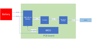

        Before answering your question, let me introduce the architecture of our related circuit. you can see our block below,KL30 is power supply and KL15 is wakeup signal for wake system
       ① For the startup waveforms,you can refer to the picture below ,as you can see ,there is no voltage spike on the startup sequence。The initial fall edge is due to the MCU disabling VN7003(hige side switch),This phenomenon is normal.
       ②about battery connection,for our project, the TPS7B8601 Input is not always on,after KL15 waked  system,MCU will enable VN7003(high side sw),then TPS7B8601 will work

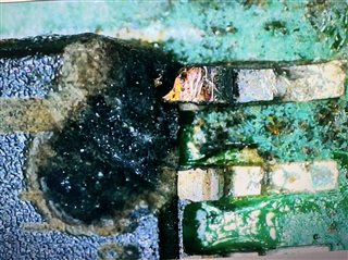

         ④ We did X-ray test ,form X-ray test picture ,we didnt find any solder short to 8PIN(battery in),and you can see the flank of 8PIN was burned out .
    Damaged chip:
    Good chip:
  • Add some detailed photos of the damaged areas:

    Thank you for the information. I do not see a good reason why this kind of damage would happen; from the pictures it looks like there was current flowing through the pin and the device, and not outside of the device (i.e. a solder short as I mentioned).

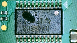

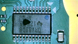

      We have a new discovery,As you suggested, we put a fresh chip to the bad board,after that the USS_9V is ok ,but the net HS1~4 still not work,so we found that the DRV8908QPWPRQ1 was also damaged. (In our ECU system ,The two chips are on opposite sides,There are a lot of heat sink glue on 8908 side. We removed those heat sink glue today, then we find 8908 damaged).And we found the problem with both bad boards is the same. TPS7B8601 and DRV8908 are damaged

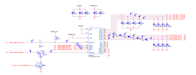

    3. Would you be able to provide us the schematic.
    4. Are you using the device in parallel mode operation?

    3. schematic you can see below
    4.The chip works independently on the PCB

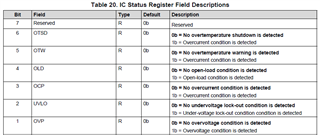

    -Do you observe one of fault flag while operating?
    Above are just general tips. If you can reproduce issue on your bench, could you share what is the trigger for damage?  Then I will try to provide more comments.

        Our ECU not for motor but for Ultrasonic sensors, one DRV channel connected 4 sensors,and one sensor current MAX is 20mA ,typ is 5mA.
        DRV's thermal pad was connected to GND plane

        The chip was damaged,so I can‘’t  observe any fault flag

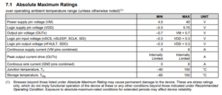

    Exceeding absolute max condition could cause device damage.
    May not be your case but just ideas.
    - VM and GND are swapped.
    -Somehow some supply voltage applied on GND line.
    -Somehow high voltage applied on logic I/O or VDD pin.
    regards
