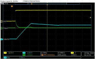

During start up, a short overvoltage appears at the output, cca 1V/3ms above 5V. The input voltage is 24V/+-10%. What is the reason for overvoltage? How can this be solved? Thanks in advance for the suggestions. Best regards, Petr.

Hi Elena. Increasing value of input cap.does not help but progress is visible when we increase output cap.. We added to current 2x47uF one cap.with value 180uF, over voltage is now 0,4V during start up. It is accept for us. Please look at the layout if you see any problem. Thank you, Petr

I have to go back to our issue. I found in the datasheet (9.2.1.2.2) that not posible use bigger output cap.than 220uF. What is the reason? What happened whan we use eg.330uF polymer output cap., KEMET T545Y337M10ATE35? Thank you for feedback. BR,Petr
If the Cout capacitance is too large then the circuit may not have enough bandwidth and causes unstable loop.
Hi Elena. Thank you for explanation. Let me summarize: layout is OK, Cin has no effect, L we tested sizes 220u/330u/470u and it has no effect, only Cout has an effect but the max. capacity of 220uF can be used, I am sending a picture. The initial overvoltage is now 5V+0.8V. Is there also a limit regarding ESR min? Do we have any other option to reduce the output overvoltage when the source starts up? Petr

Hi Elena,
I'm attaching measurements with an output capacity of 2x150uF and Gain and Phase measurements for a 100mA load. The output voltage is now below 6V with some margin. Can you please evaluate whether this combination of output capacitor can be used?

hi, Petr,
The Vout waveform looks good, and could check under 100mA the device is CCM mode , usually we test loop stability in CCM, if it is DCM , the it will not have loop issue.

Petr,
Usually we required phase margin 45 degree and gain margin -10db around, checking the test result , it looks good .
