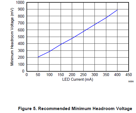

I need the 400mA design on my setup. I have changed R26 (ISET, 37.4K, 130mA) to 12.3K ( I believe it will make 400mA) based on ILED(400mA) =VISET(1.229)/R26(12300) x KISET(3992). Actually I fed 5% duty 60Hz PWM, and changed the R26 to different values, but it works up to around 280mA (R26 =  18K). I could not get a working condition either with R26 = 16K (it would be ILED = ~300mA). It works ok with R26 = 18K (it would be ILED = ~280mA). Please advise how to make the ILED = 400mA working condition on the TPS61196EVM-600 board?
  • Hi Sung,
    Please check two resistors:
    1. Resistance of R23
    This resistor together with R26 will determine the VIFBV, this voltage should be larger than 900mV if you want a 400mA output current.
    In the formula below, R10 is R23 on EVM, R11 is R26 on EVM. And to remind you, the 400mA output current is in pulse mode.

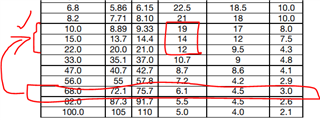

    Well, I have one question. Actually the TPS61196EVM-600 design is 150mA, is there a possibility to change the inductor values to increase the current for the 300mA/400mA setting? I would like to confirm whether the inductor part (L1, 68uH, IHLP6767GZER680M1) is ok for driving 400mA to all six channels. If I need to change the inductor value for the 400mA design, then would you please recommend proper inductor parts? Please advise.

    The inductor on EVM is suggested to work with input current below 6A, but your working conditions require the input current larger than 12A. So I suggest you to choose an inductor with more current tolerance.
    Here is the datasheet of the inductor on EVM: IHLP6767GZER680M1
    BR
    Patrick
  • Hi Patric, then, do I need to use the low inductance parts? 10uH has 19A size... Will it be ok in terms of the TSP61196 part spec of the boost switch frequency range?
  • Hi Patric, BTW, I will use 10% duty ... Would you please confirm the inductor part selection again with 10% duty of 400mA/6ch?
  • Hi Sung,
    Though your duty is only 10%, but with PWM dimming mode, the maximum current on inductor is still 12A. So I suggest you to choose a new inductor. And it will be better if the inductance remains the same as before.

  • Hi Patric, Got it. I found an inductor in Digikey, it is a Pulse inductor and I am considering using 47uH or 68uH. Would you please confirm whether the part can be a reasonable design of my application (400mA, 10ea 5.7V dual LEDs, 6ch, 12V in)?
    https://www.digikey.com/en/products/detail/pulse-electronics-power/PA4349-473ANLT/7943172?s=N4IgjCBcoEwAwA4DsVQGMoDMCGAbAzgKYA0IA9lANogBsCABAK0ASIpALEk6wLqkAOAFyggAqgDsAloIDymALKFs%2BAK4AnQiAC%2BpeAgSoQGSDgIlyVcO3oBBEHxBCRE6XMXL1mrTpAxL-MgB3QjV6SXEAExU0QTI1ey0gA
  • Hi Sung,
    This inductor seems to be propriate. One more thing, is the inductor package suitable for your design? This one seems a little larger than which on EVM.
    BR
    Patrick
  • Hi Patrick, thanks a lot for your help. Yeah, I need to make a little larger pad for the new inductor.
