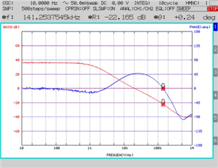

Measured FRA data for TPS61022 is attached below,
Phase margin is 0°or less on low frequency range, is this problem for unstable and should improve?
When add Cff: 100pF (referenced by Cff equation), phase margin is increase(improve) but input current become large, I guess that the same pattern for below thread.
https://e2e.ti.com/support/power-management-group/power-management/f/power-management-forum/1108222/tps61022-input-current-abnormal/4112132
If possible I want not Cff, or change small Cff value (lower than correct Cff equation result) for reduce input current.
I want to judge above points: problem or not, and Cff need to add or not need.

  • Hi Satoshi,
    By definition, PM is the phase difference between 180 and the phase at Gain=0dB. And more, I don't think phase < 0 on low frequency range is a problem for unstable. PM >= 45 and GM >= 10 is enough, so Cff is not needed according to your bode plot.
    Nathan
  • Hi Nathan,
    Thank you for reply,
    I think although there have a limit, phase become <0° and not reach -180° on low frequency range will be stable, correct?
    Is there any reference document?

  • Hello Satoshi,
    What exactly are you measuring? Phase or phase margin? You could check if there is an issue if you apply the frequency where you see a value below 0 to the feedback node and check the output voltage.
