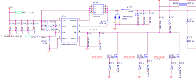

Hi Team,
Customer designed LM3489 in new project.
Would you please help review  slew rate question and provide your comments?
During voltage transition, the slew rate should not exceed vSrcSlewPos (vSrcSlewNeg), which is 30 mV/µs according to the PD specification.
vSrcSlewPos ≤ 30mV/us
customer measure the 5V to 20V case, slew rate is over 30mV/us.
15.2V/340us=44.7mV/us
If need to add bulk cap, would you please provide suggestion and how to add the bulk cap to slow the slew rate?
Thanks for help!
