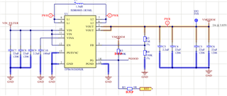

I'm using the following configuration for the power supply connected to a ~50ohm load.

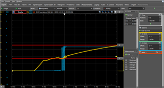

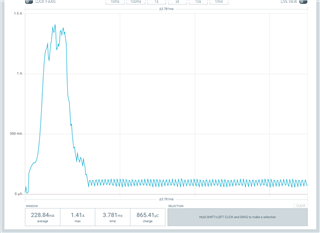

During some preliminary tests in regard to the DCDC converter  start up, I'm getting the following curves for the Vin and Vout  lines and a in-rush current profile.
As visible, the approach used for the EN's connection differs from the datasheet ( it was connected directly to VIN instead of VINA), so instead of waiting for a more stable input voltage, after turning on the system, the DCDC is enabled as soon as the input voltage is 1.2V.

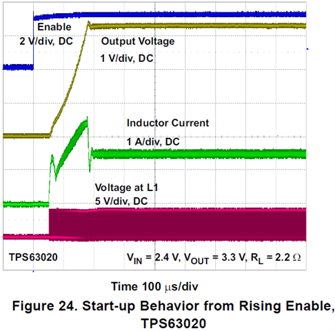

 - Does this indicates that, as the converter is enabled and the output capacitors are seen as short circuit during this initialization, the converter goes to PWM mode (Iout>100mA)?

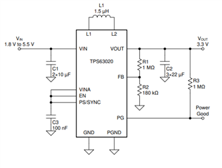

- The illustrated connection show that EN is connected to VINA where an internal resistor is present between VIN and VINA. What is its value?
- Is the purpose of this configuration to create that enable delay and mitigate this initialization behavior?

  • Hi   Fabio,
    that is right, you can see the picture below as ref.
    the resister internal is around hundreds, and the purpose of this configuration is to make a cleaner supply for block internal. you can take this as a RC filter from Vin to VINA.
    also, you are right about the delay of EN, but i think that is not our initial goal.Joy

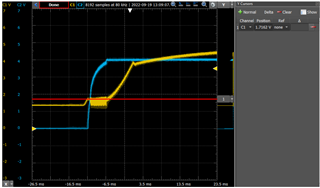

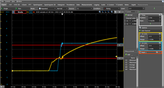

    Considering the previous circuit configuration and applying a current load of ~350mA at the converter's output, I'm getting the following behavior on the following signals:
     - Vin vs Vout
     - Vin vs PGood
    From my understanding, as the EN pin is directly connected to Vin, the converter is enabled when the input voltage is still unstable.
