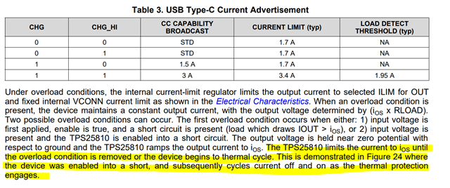

Dear Team,
1. How many Amps is the STD current?
2. When the current reaches 1.7A, will the current be stuck at 1.7A? or protect

Hi Jimmy,
Apologies for the delay response.
1. I believe the standard Type-C current is 900mA (0.9A)
2. The device should limit the current until the condition is removed or the device begins to thermal cycle:
3. If the connected sink device only needs to draw 2A, then the TPS25810 will only provide 2A.
