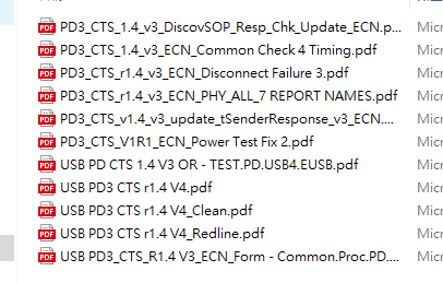

Customer would like to design TPS65987DDK in the latest monitor application.
Is TPS65987DDK the right solution to pass latest PD spec as below?

Hi SSH,
Is the customer planning on integrating USB4 or TBT4 into their design?

Hi SSH,
You can find the USBIF Compliance Information using TID# 5431. This device passed USB-PD 2.0, UBS-PD 3.1, and Type-C Specification.
Link here for direct access (USBIF account needed to view this information): https://cms.usb.org/usb/cms/device/42717
