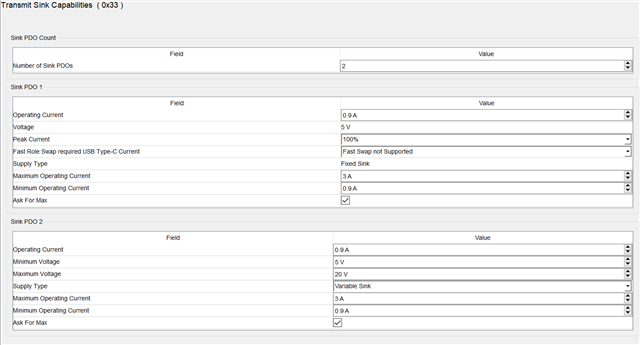

we have a TPS65987D configured with 2 sink PDOs with the following:
  1. Fixed Sink: 5V / 0.5-3A  (ask for max)
  2. Variable Sink: 5-20V / 0.5-3A (ask for max)
Our product has an external supply and a battery the USB-C power is only used to supplement the other power sources, so we want accept whatever the maximum is the source can provide.

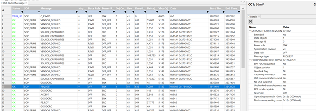

  • Hi Raymond,
    I am now able to log the PD messages.
    The port I am testing with on the Laptop can support 15W (5V/3A).
    From the logs I can see that 15W is being negotiated correctly.
    Also the data from both logs is identical, when I get the warning or not.
    It seems to only be dependent on if a 2nd PDO is configured.
    TPS config that generates warning.

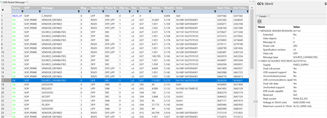

    TPS config that does NOT generate warning.
    However obviously in this case only 15W  can be connected.
    We can support up to 60W.

    I also don't understand how Windows know that our device can support more power if available as the information doesn't seem to be in the PD logs.
    Within the REQUEST message, the Capability mismatch bit can be toggled to let the source know if the sink is able to obtain the required power from the source. Windows most likely reads this bit and generates the "Your PC might not provide enough power" message when it is high.
    What this indicates is that the sink is expecting some minimum wattage to be supplied and the available source PDOs are not capable of providing that minimum. (i.e.. The PD auto generates a 60W (20V3A) minimum but the notebook can only provide 15W(5V3A))

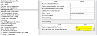

    To fix this, you should only need to manually set the required power.
    Within the GUI, navigate to the Port Settings -> Autonegotiate Sink.
    At the bottom, you should be able to adjust the Power Settings. Uncheck the Auto Compute Sink Min Power to prevent the device from automatically setting the Min Required Power based on the programmed sink PDOs. Then you can set the Min Required Power manually to 7.5W (or whatever you desire) in the box below.

  • Hi Chris,
    Thank you, once I found the settings in the advanced configuration I was able to change it and it solved our issue.
