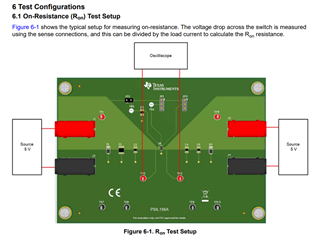

    I will measure the TPS22998EVM and confirm the Ron.
    Maybe last question, what is the gate voltage for internal N-ch MOSFET?
    This specification is need for measure and confirming.
    Satoshi
  • Hi Satoshi-san,
    The internal gate voltage is not a value we provide.
    The Ron can be measured using the TPS22998EVM User's guide and the diagram below:
    https://www.ti.com/lit/ug/slvucb6/slvucb6.pdf?ts=1664981565410&ref_url=https%253A%252F%252Fwww.google.com%252F
