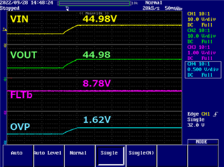

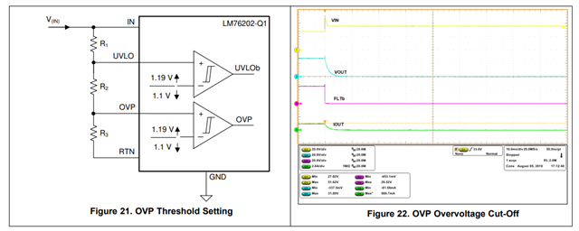

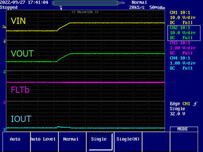

Q1. The OVP of the LM76202 is set to 33.6V, but even if I connect a DC power supply and make the input voltage higher than 33.6V, the output voltage does not turn off. Why is this?

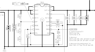

Q2. I made a mistake in the circuit diagram and connected PAD to GND, so I reconnected PAD to RTN, but OVP did not work as expected. Please check to see if there is any error in the circuit.
