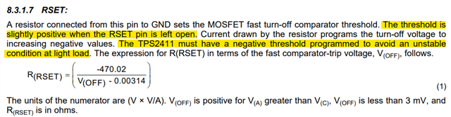

3. Can this device support about 1mV VSD reverse off threshold?

    3.  Yes, using RSET, we can program the reverse turn OFF threshold to required value of 1mV using the formulae below.

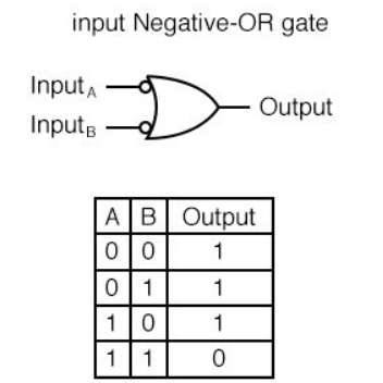

    I have a question about the logic diagram of this IC.
    ________________________________________________________
    In DS, it says Fault is active (low) for any of the following conditions:
    • Insufficient VDD
    • GATE should be high but is not.
    • The MOSFET should be ON but the forward voltage exceeds 0.4 V.
    There are two assumptions, which exists in normal operation.
    Assuming the voltage between GATE and A is higher than 0.75V;
    Assuming the voltage between A and C is lower than 0.4V.
    But from the logic diagram showed in below, FLTB is 0 logic in above assumption, which is constrict with
    the description in DS.
    Could you please help to check whether the logic diagram has error?
    Best regards
    Shuai
  • Hi Shuai,
    The correct block diagram should have an inverted input OR gate as shown below. That is if any of the inputs is 0, then the output of the OR gate should be 1. If both the inputs are 1 (i.e. NO Fault condition) then the output of OR gate should be 0.
