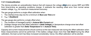

The autocalibration feature on the bq34z100-G1 seems to hindering things on the end user's system due to the 16 second delay as it calibrates the CC Offset.
The autocalibration feature can't be disabled, but it looks like an EXIT command can be sent.
What are the effects of exiting? It seems like the CC Offset won't update, but how much can that value change?
I can't imagine if would affect overall accuracy that much.
Lastly, are there any parameters that can be changed so that the autocalibration will wait to meet conditions until it is okay to enter calibration in the system?

    The gauge does autocalibration automatically when operating conditions change, see above. Offset calibrations are aborted when the load has likely increased considerably, hence you shouldn't worried about accuracy.
    CCA bit from control_status can be monitored to know when CC calibration routine is active.
    See the picture above. Technically, Deadband.

    1) If auto-calibration has begun, it must go through the whole 16 second process, is that correct?  In the system this is installed in, a load is applied and the auto calibrate is not aborting.
    2) Is there a current threshold that would allow for an auto-abort?

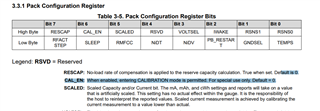

    Is CAL_EN bit set in Pack Configuration Register? This will enable calibration mode.

    When you send the exit calibration command, you are technically overwriting the CC without adding offset. This is why CC offset won't update. Exiting calibration mode will set the Calibration Mode flag off, and calibration offset flag off.
    I wasn't too clear in the first reply. If (initial voltage - current Voltage) > calibrate offset  voltage drop (this should be 0V by default). This means the load current has likely increased considerably. Therefore, offset calibration will be aborted.
    A workaround here will be to manually send the exit calibration command, and make sure CAL_EN is zero in Pack Configuration Register.

    CAL_EN is off in the Pack Configuration Register.

    The part is the bq34z100-G1.  Is it possible that the auto-abort isn't working because the voltage drop isn't greater than the calibrate offset voltage drop
    Kevin
  • Hi Kevin,
    Yes, this is the condition for the gauge to abort autocalibration.
    Check with the customer if the voltage drop is greater than 32 mV
    Calibrate offset voltage drop by default is 32mV

    The 16 second calibration still takes place.  In the datasheet for the bq34100, which the bq34z100 is based upon, there is a mention of a specific 16 second delay that has to do with the I2C lines being held low.
    "During normal Gas Gauge Operation when the I2C clock and data lines are low for more than 5 seconds and Average Current is less than Sleep Current in mA, then an automatic CC Offset calibration is performed. This takes approximately 16 seconds and is much more accurate than the method in Calibration mode."
    Can you clarify if that should state the lines are idle instead of low?  The I2C lines are never held held low in the application, so clarification as to whether the conditions are stated correctly in the datasheets and TRM would be helpful.

    It would nice to have clear definitions and values for all of the variables listed in the Autocalibration section of the datasheet.
    This would include:
    • Bus Low Time and if the I2C lines need to be low or idle.  The datasheet states low, but you has said idle.  If so, that datasheet will need to be corrected.
    • Autocal MIn Current.
    • Delta Voltage
    • Delta Temperature
    • Autocal Time
    • Cal Abort
    What we seeing is that there is a 16 second Autocalibration taking place when applying a load.
    We want to be able to read the current from the bq34z100-G1 when applying the load but we cannot because it reports zero until it completes and it is causing problems in the system.
    The load current doesn't appear to be enough to abort the Autocal either.  The voltage drop created is greater than 32mV, but I have only seen the Autocal abort when applying a much larger load current, and the voltage drop is in the 400mV range.
