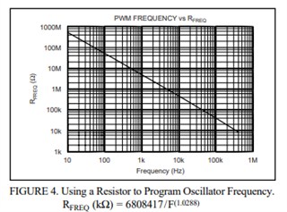

    The formula to calculate the Rfreq is below:
    Iref = 1.3V/Rfreq
    so for 500 Hz (also in the table) Rfreq = 11.3 MΩ

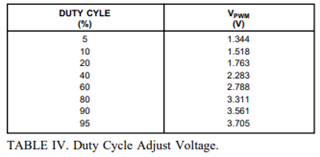

    By using the following table we can get the linear equation for D% to Vpwm:
    If we ignore below 10% and above 90% and choose a D% between 10 and 90 we will have more accurate results:
    D% (between 0.1 & 0.9) = 0.3903*Vpwm-0.4904
    So lets say at 40% duty cycle with Rfreq(500Hz) = 11.3 MΩ you want to know what Rduty to choose:
    Vpwm = 0.4/(0.3903) + 0.4904/(0.3903) = 2.28V
    2.28 = 2.75*(1.3/(11.3*10^6))*Rduty
    Rduty = 2.28/(2.75*(1.3/(11.3*10^6))) = 7.2 MΩ
