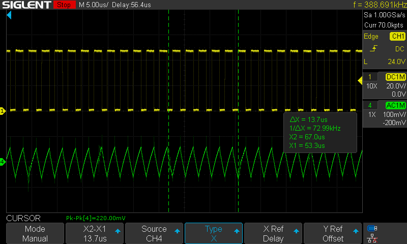

  • Hello Orlando,
    Sorry for the late reply, but I reprobed the SW node. It looks like I was probing something else on the circuit in that first shot. Here's the new scope shot:
    CH1: SW, CH4: VOUT (AC COUPLED)
    I have an electrolytic and ceramic capacitor in parallel at the output. The ceramic capacitor's ESR is 17 Ohms (DF of 0.05 at 1000kHz, 0.47uF). The electrolytic is 0.16 ohms.
    I am using an E-load to apply a constant current load of 3A.
  • Hi Jerome,
    This waveform looks good, the converter is switching fine.
    The output voltage ripple pk-pk is large, but that should not cause those glitches. (look like very high frequencies)
    The ceramic ESR is 17Ω?? That seems very high for a ceramic capacitor, is it leaded or SMT?
    I'd say try removing that capacitor or using a different ceramic. Ceramic ESR should be mΩ scale.
    Also please confirm with a resistive load. It could be the Eload control loop trying to react to the output voltage ripple.

  • Hi I tried a different scope and I still see the noise:
    One thing I did realize is that this noise is about ~70kHz which is the switching frequency of the ACDC that gives the VIN of the LM76005... I will try to filter the input a little better and perhaps that will solve the issue.

  • Hi Jerome,
    Looks like you're having some interactions between the AC/DC & the DC/DC converters.
    Is there a filter between the two converters? You may want to place a magnetic (inductor or bead) between the output of the AC/DC and the DC/DC.
    What capacitances do you have on the DC/DC input? You can try to increase that input capacitance as well as dampening that node with a capacitor with ESR, like an electrolytic.
    You should probe VIN & VOUT ripple together, as well as some control signal from the AC/DC, and try to see what is happening at that moment the VOUT ripple is noisy.
    Hope this helps,
    -Orlando
