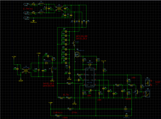

  • Hi Massimo,
    I had similar project to do.  My choice was CCM average current PFC driver to drive Sepic converter. Sepic does not have problem with inrush current and excellent separation load / power source. Also easy to control EMI. Charging algorithm for capacity is "Constant Current" than "Constant Power" and on the end "Constant Voltage". In your application ,I 'm guessing ,  "Constant Current" will be 4-5A and" Constant Power" about 400W . Charing time  (if you charging  cap from 0V) will be about 20 sec.

  • Hi Dragan,
    So You'are using a pfc controller to drive a sepic instead to drive a traditional boost, is it right? what kind of controller do You suggest?
    regards
    massimo
  • Hi Massimo,
    Yes, and I used IR1150 but  you can use any CCM controller. This is picture of schematic and I hope you figure out how to make interface boost driver to  Sepic converter .This schematic gives me 250W  @  universal input . Coil are separate and to reduce switching loss D6 is SiC-diode.Efficiency is about 94%..
