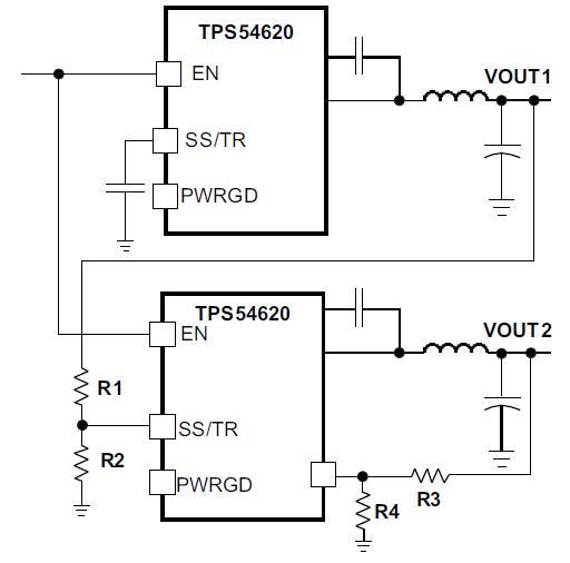

My customer want to use TPS54325 to track another output. Can we use the similar circuit which is suggested in TPS54620 as following picture?
  • That feature is not documented ar characterized, but it does appear to work.  I did a quick test in the lab and teh output will scale with the SS voltage for SS between 0 and  0.765 V (approxinately).  You will want to ensure that the SS voltage ends up well above 0.8 V
