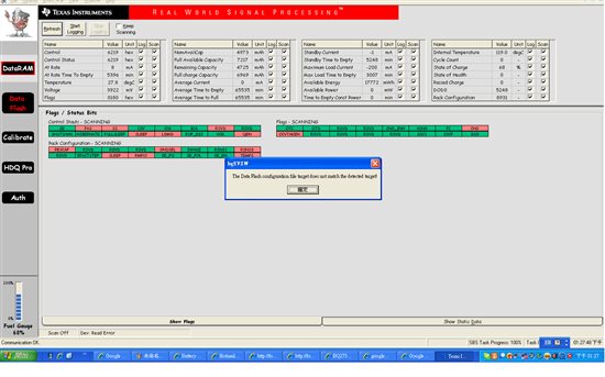

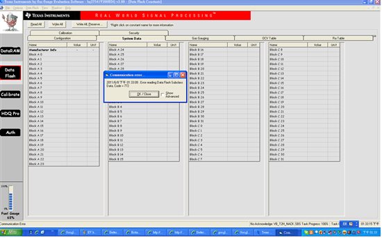

Are you having trouble reading bq27541 dataflash using EVSW and EV2300?
Is it connected to a bq27541EVM or your own board?
The HDQ communication is very slow and it will take some time to read all dataflash.
Please upload a screenshot of your error to explain your problem.
Your DataRAM screen shows the FAS and SS bits are set which means your device is sealed. You must first unseal it before being able to read the dataflash.
