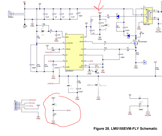

1.My customer is interested in using LM5156 as flyback in primary regulation,
But the calculator only support secondary regulation, and I couldn’t  find more related schematic about primary regulation in the datasheet.
Would you provide any excel tool and schematic of LM5156 that can support my customer design with “primary regulation”?
2.and another question for below picture, is the Vload1 voltage designated by turn ratio to primary side or feedback resistor  ratio like normal boost  application?
Fred

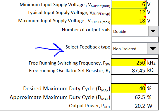

  • Hi Fred,
    Thanks for reaching out. In the Excel file you can select Isolated or Non-isolated in row 12.
    What are the specs for this design? In the reference design section of ti.com there might already be a ready reference design for a PSR flyback with this device (or with the LM5155). The voltage divider on the FB pin of the IC is calculated to give 1 V with respect to the voltage of the winding.

  • Hi EM,
    if I chose "isolated", it only shows secondary regulation. Even EVM itself is secondary regulation as well.
    so calculator doesn't have primary regulation setting, right?

    In this case you could choose 'non-isolated' for the PSR flyback, keeping in mind that the winding used for the feedback is on the primary side of the transformer and not on the secondary. If for example the AUX winding voltage is 10 V, you need to calculate the feedback divider with respect to having 1 V on the feedback pin, for example 5.5kOhm and 50kOhm (because 1V/5.5 *(50+5.5) = ~10V).
    The EVM can be configured as PSR flyback too:
    Here an example of PSR Flyback  https://www.ti.com/lit/df/tidm430/tidm430.pdf
