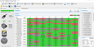

  • Hello Mohan,
    Can you share your .gg file and screenshot of the main bqStudio register page when you boot up the gauge? This sounds like the gauge is trying to go to shutdown mode usually from low voltage, so I would make sure your connections are secure and the voltages the gauge measures are what is expected.
    Sincerely,
    Wyatt Keller

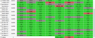

  • Hello Wyatt ,
    Please find the attachment. Currently we shorten the PACK + and BAT + , then only we can communicate with BQ studio.
    Export1.gg.csv
  • Hello Mohan,
    From looking at your register dashboard it appears the issue is what I mentioned at first since the SDV bit is set the gauge is trying to enter shutdown mode. Please double check your cell config register to make sure you have programmed the appropriate cell count. You also have the CUVC protection triggered.
