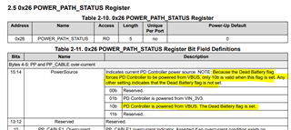

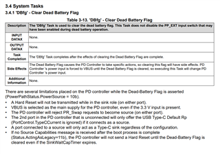

Good day! We're having issues with the dead battery mode.
We want the chip to wait until we clear the dead battery flag (but it basically exits dead battery mode immediately and reads it's configuration).
Before our host controller is up and can clear the dead battery flag. How do we get the chip to wait until a host controller clears the dead battery flag?
