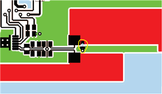

                    We wanted to integrate the BQ34Z100 IC into our BMS board. We are having some confusion about the different ground system.
We are using a 4 layer board.
BAT- will be a copper pour on front copper and Pack - will be a copper pour on front copper connected to the BMS ground(Internal Layer) through VIA .
The BMS Ground has the charger ground and load ground.

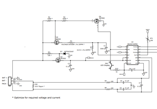

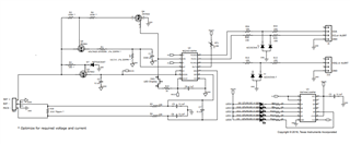

We wanted to know if the grounds shown in the BQ34Z100 Circuit also connect to the BMS Ground or should it be an isolated ground .
1) If they connect to the same BMS GROUND , what happens to the net tie
