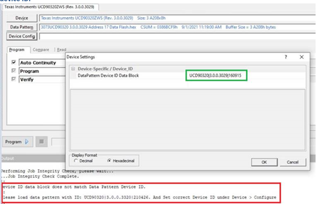

Hi TI Team,
The lot failed for ID check as in screenshot below. We have run few lots previously without any issue. Please help to advise below:
1) When TI have update the device ID with the new firmware?
2) Please advise when is the affected datecode with this new firmware.
3) How we can differentiate the firmware upfront (before production loading) as this will affect the device ID.
Example: A typical DEVICE_ID string is UCD90320|3.00.0.3029|160915. In this example,
Hardware device = UCD90320
Firmware Major Release = 3
Firmware Minor Release = 00
Firmware Sub-Release = 0
Firmware Build Number = 3029
Firmware Build Date = September 15, 2016
From the datasheet, this differences is because of the firmware build number and date.
