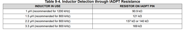

1. does charger reads inductance value only to provide the accurate IADPT ?
or it has other arrangement  or purpose for this ?
2. can it read the inductance that is not on this table?
ex.1.7uH?
please send materiel to me if you think it's more proper
