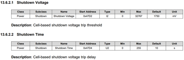

May you let me know if we can set Cell undervoltage value = Shutdown voltage?
As I know, they have 8s trip delay which means that if both of cases occurred, BQ40Z50 will do CUV first and then shutdown instead of the same time. Is it correct?
If you don't suggest the same value between both of them, do you have any suggestion for minimum voltage gap? Thank you.

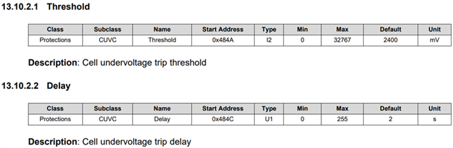

    Generally the CUV is much higher than the shutdown voltage as you can see from the default settings, the shutdown is usually wanted when the gauge is very over discharged and the maximum power conservation should be entered. CUV is more meant to stop a discharge if the battery voltage drops very low, either in active discharge or relax to stop from discharging more. This leaves a buffer of energy for the gauge to remain active until the batteries eventually hit the shutdown voltage.

    So may you let me know if we set the CUV voltage = shut down voltage, what is the risk?
    And may you let us know the scenario that suggest use CUV instead of shutdown mode?

    It it up to the application requirements, there is no issue with these settings from a firmware point of view. It is a strange setting since in shutdown the FETs will be off so discharge will be prevented until a charger is applied. So the CUV may have little affect on the behavior.
