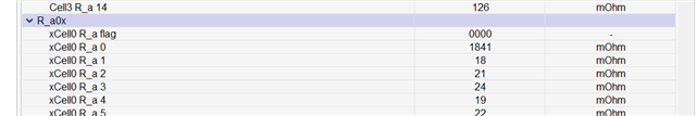

After running the sw & fw, I found that all data have been successful updated except xCell0 R_a 0, xCell1 R_a 0, xCell2 R_a 0 and xCell3 R_a 0.
I'm sure that the sw & fw has successful write the value into address 0x41C2 (xCell0 R_a 0), 0x41E2 (xCell1 R_a 0), 0x4202 (xCell2 R_a 0) and 0x4222 (xCell3 R_a 0).
I have another sw & fw which is able to read data flash value from BQ and i found that address 0x41C2 (xCell0 R_a 0) has been updated to 0x11 (17).

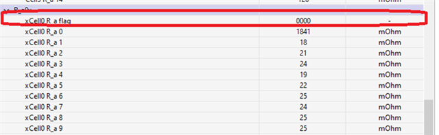

During the verification, I found that 0x41C0 (xCell0 R_a flag) also not same with what shown on Battery Management Studio.
I would like to know why the value direct read from data flash is not tally with what shown on Battery Management Studio and is there any solution?

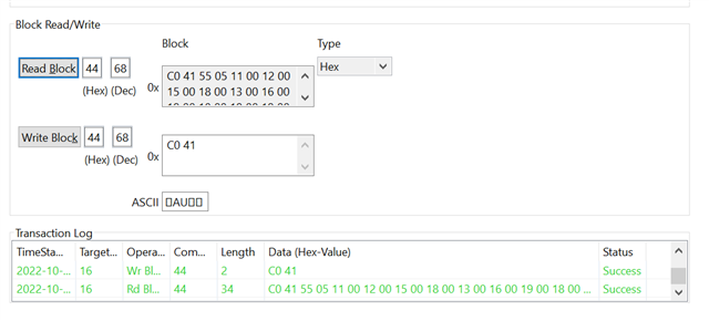

    I would recommend that you send the same commands through bqStudio Advanced Comm. This is to verify that you get a successful update or not with the commands that you are send.
  • Hi Shirish,
    I've used bqStudio Advanced Comm to read block data from data flash address 0x41C0 and i got same result as what my software read.
    0x41C0 (xCell0 R_a flag) = 0x0555
    0x41C2 (xCell0 R_a 0) = 0x0011
    Whereby bqStudio Data Memory still showing xCell0 R_a flag is 0000 and xCell0 R_a 0 is 1841.

    I attached the Advanced Comm SMB log file.
    Based the DF data,
    0x4140 ~ 0x415F = R_a0 data
    0x4160 ~ 0x417F = dummy/reserved data
    0x4180 ~ 0x419F = R_a1 data
    0x41A0 ~ 0x41BF = dummy/reserved data
    0x41C0 ~ 0x41DF = R_a2 data
    0x41E0 ~ 0x41FF = dummy/reserved data
    0x4200 ~ 0x421F = R_a3 data
    0x4220 ~ 0x423F = dummy/reserved data
    0x4240 ~ 0x425F = R_a0x data
    0x4260 ~ 0x417F = dummy/reserved data
    0x4280 ~ 0x429F = R_a1x data
    0x42A0 ~ 0x42BF = dummy/reserved data
    0x42C0 ~ 0x42DF = R_a2x data
    0x42E0 ~ 0x42FF = dummy/reserved data
    0x4300 ~ 0x431F = R_a3x data
    0x4320 ~ 0x433F = dummy/reserved data
    Please verify whether it's TRM problem or bqStudio problem?

    I'm sure you are seeing wrongly.
    xCell0 R_a_flag, xCell1 R_a_flag, xCell2 R_a_flag, xCell3 R_a_flag are value 0000 in both before.gg.csv and after.gg.csv file.
    Please take note that this is xCell data, there is an 'x' in front.
  • Hello Jack,
    Sorry for the confusion. I just checked the addresses and it seems to match what you observed.
    Tip: You can get the addresses by choosing Advanced Views in Window-Preferences menu.
  • Can you confirmed that the Technical Reference Manual is wrong?
  • Hello Jack,
    We always recommend using the BQZ to see default values and specific addresses since these can change with the build so they may not match the TRM since there could be multiple builds of the same Rx firmware that causes the addresses to change.
    Sincerely,
    Wyatt Keller
  • Hi Wyatt Keller,
    Do you means that if there is conflict in between bqStudio and TRM, bqStudio is the one to be trust?
