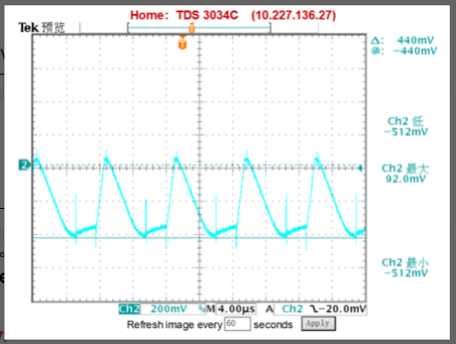

Hi team,
I am Jayden, I have question about LM5145 ILIM Pin. The maximum voltage between ILIM and GND is about -440mV with shunt resistor current sensing mode in my customer's application. But the absolute maximum rating of ILIM is -1V and the recommend value is 0V in datasheet. Is it ok for the application? will it affect the long-term stability of the ship?
