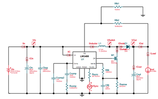

I use LM3488 as a boost converter from a car battery to 26V/3.53A output. It supplies TAS5414 audio amplifier. Its total input capacitance is 177.4uF and on the output 246uF. At the moment I am supplying it from a lab power supply which has about 0.3 Ohm resistance (inc. cables). Target appliance will have 3 meter long supply cables of AWG14.
The issue is as follows: when the power amp is disabled (default) LM3488 boost converter works with almost no load, but when it tops-up output el-caps' charge it draws current as high as 12A which causes input voltage to drop below level at which the power amp UV threshold.
I would like to limit this current. Preferably below 5A. What would you recommend?

    No, I do not mean inrush current. The boost converter starts-up and afterwards repetitively tops-up already charged output el-caps to compensate for a light load. Each time it does this it draws about 12A from the input. By repetitively I mean a short group of pulses starting with the before mentioned 12A one and then about 0.8s no switching time.
    For now I have tackled it with an extra 100nF capacitor in parallel with Rfb2. The peak top-up current dropped to an acceptable 2A, top-up time increased at the cost of the output voltage, that seems to be slightly more fluctuating under the load.

    100nF feedforward cap on the feedback node seems to me a bit high. I would try to increase the crossover frequency by changing the compensation components. You could either work with load transients or bode plots to check this out.
    Brigitte
