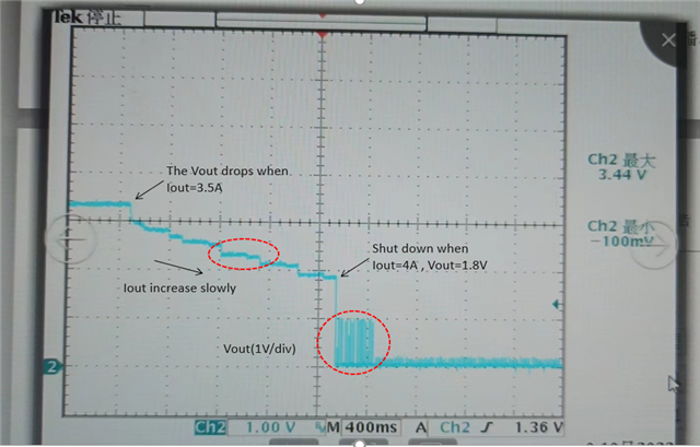

Hi team,
This is Jayden, I have question about the OCP. The Test conditions is Vin=12V and Vout=3.3V. The waveform below is Vout.
The Vout drops when Iout=3.5A (As I calculate, ΔIL=1.196A in this condition). Then slowly increasing the Iout. When Iout=4.0A and Vout=1.8V, the 82130 shut down. Then the Vout fluctuates between 0V and 1V.
The questions are as follows:
1. The Iout=3.5A has reached the OCP, right? If so, the inductor peak current is limited to current limit. As the Iout increase, the vout decrease. If I don't increase Iout, the Vout remains constant. Is this because of power limitations?
2. 82130 shut down when Iout=4A and Vout=1.8V, Is this because of UVP? I can't find Vout UVP value in datasheet.
3. The TPS82130 do not have the hicccup. So why the Vout fluctuates between 0V and 1V after it shut down?
Best regards
