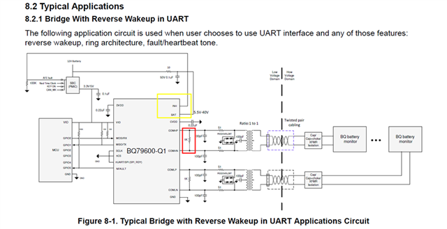

My customer want to use UART for reverse wakeup:
if VIO voltage=0V,BAT (15pin) voltage=6.5~18V, device whether can trigger reverse wakeup function that mean is INH(16pin) can output wake up signal?

In this example, the INH pin is connected to a PMIC to enable it for reverse wakeup. When INH is not activated, this pin goes into a high-impedance mode. When activated, this pins outputs a voltage from Vbat (minus V_drop_INH). It does not send a wakeup signal. It should be used to drive the enable pin of the other device.

So, is customer want to use to VIO voltage=0V, BAT (15pin) voltage=6.5~18V condition okay? we want to make sure when VIO=0V,work around can work?
