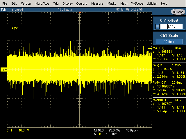

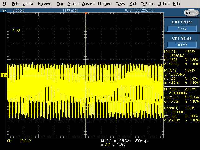

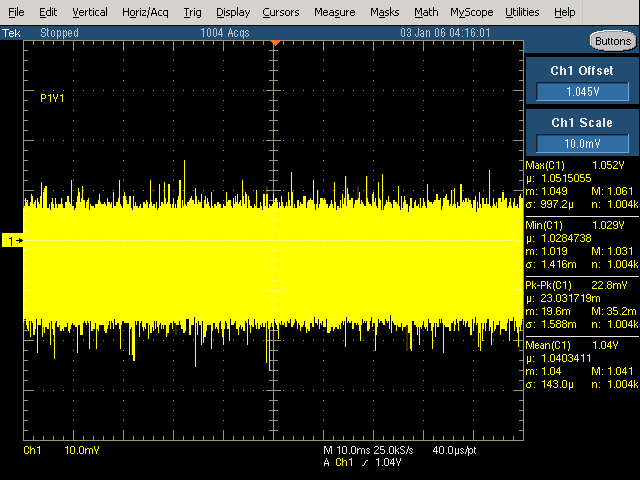

3. Since this is the first time I use margin function, could you help check if following waveform is OK or not?
*VR is TPS568215RNNR, Margin high/low is +- 5%
*The first waveform is single shot, the 2nd is 1k acqs.

(2) 1.1V (Margin high = 1.155V, Margin low = 1.045V)
=>Margin high
=> Margin low

    3. 1V1
    R3/R4 = 54.9k ohm, C1 = 220p F, FVR = 400kHz, F DPWM = 1MHz, Duty cycle = 18%
    =>Margin high target (nomial) = 1.155V, Vpp < 11.55mV
    Measurement mean = 1.141V, Vpp=20.4mV
    =>Margin low target (nomial) = 1.045V, Vpp < 10.45mV
    Measurement mean = 1.04V, Vpp=22.8mV

    5. 1V8
    R3/R4 = 20k ohm, C1 = 3.3n F, FVR = 1.2MHz, F DPWM = 500kHz, Duty cycle = 18%
    =>Margin high target (nomial) = 1.89V, Vpp < 18.9mV
    Measurement mean = 1.884V, Vpp=22mV
    =>Margin low target (nomial) = 1.71V, Vpp < 17.1mV
    Measurement mean = 1.701V, Vpp=35.6mV

  • Hi
    Have you followed this tool with all the correct input? in the other post, i saw that the inputs do not match.
    If the ripple is too large, either reducing the pwm frequency or increase the C1. you have tested on the own board.
    Yihe

  • Hi
    There are two ways to reduce the ripple:
    reducing the FSW or increasing the C1.
    Yihe
