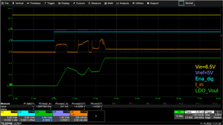

we are considering to use the TPS7B4254-Q1 LDO in our design in an automotive application.
I could not find a startup waveform neither in the datasheet or the EVM document. I found only one image from the forum which shows the startup behavior of the device.
Here is the schematic:

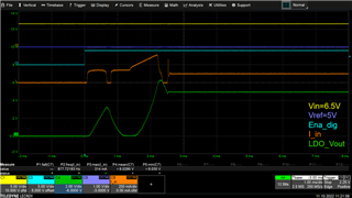

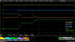

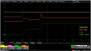

I am attaching the waveforms during startup with different load conditions (Iout=0, 50, 100, 150mA):
From the images the legend is visible.
I would like to ask you about the output voltage (GREEN) waveform. Is this a normal behavior?
Could you please explain what is happening here?
