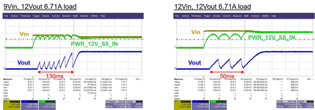

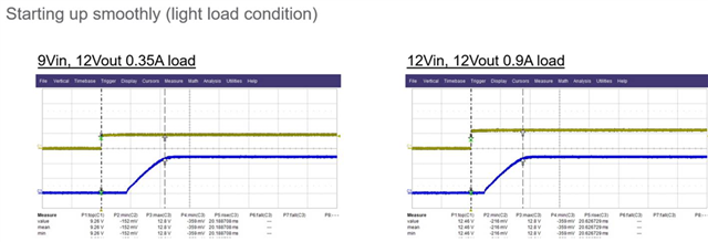

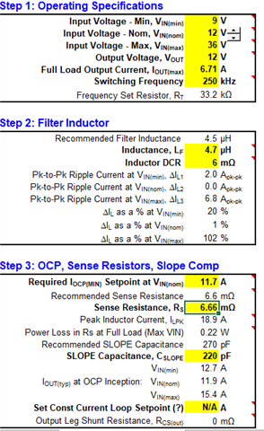

my customer encounter this hiccup during start up , is there something wrong with the calculation of the OCP?
please check the schematicLM5176_schematic_20221012.pdf
as you can see the calculator set OCP at 11.7A, so it's not supposed to trigger hiccup.
  • Hello Fred,
    When a converter starts up, it needs to charge the output capacitors, so it could happen that a lot more current is needed than during normal operation. Especially when using a current load. Can you ask the customer to check if he can use a resistive load instead of a current load?
    You could as well disable hiccup mode and check how the startup looks then.
    Please check if the problem disappears when reducing the sense resistor value.

  • Hi  Brigitte,
    you're right, they turn on the load first before the power on, so large current sink to output and trigger OCP,
    so my question is , can they prevent this situation by increase the soft start cap?
    since we don't want to set the OCP higher for this
    Fred

  • Hi Wardak,
    soft start is meant to help this situation, so extend the soft start time supposedly can prevent the inrush power on current,
    so please check again on this.
    let me put in this way,  if there's a resistive load , does soft start extension will reduce the current peak during power on?

  • Hi Wardak,
    they change soft start cap to 2uF,
    12Vin stop hiccup and 9V vin still has this issue,
    should we keep increasing the SS cap?

  • issue has been solved after they change to 4.7uF
