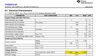

Would you confirm if the min & max on the Voltage Reference specs include the impact of radiation and aging along with temperature, load and Supply voltage variations?
Hi Steve,
Yes the range of the spec includes variation from temp, load, supply voltage, radiation and group C aging.
