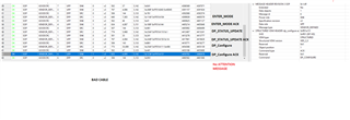

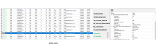

    From the logs you provided, the main difference that concerned us was the missing ATTENTION message after the DP_CONFIGURE messages. The ATTENTION message is what passes the Hot plug detect(HPD) signal and is what Display Port uses to know when a new DP device is connected. You are not getting any display due to this message missing.
    Bad Cable
    Good Cable

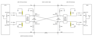

    We think the issue with the Lindy cable could be related to missing SBU lines. USB-C in DP mode uses the SBU lines to to detect a device. If no device is detected, the monitor will go to sleep and there will be no display. We think that once some of the USB-C DP messages are sent, it checks the SBU line for a device and doesn't see anything, so never sends the ATTENTION message.

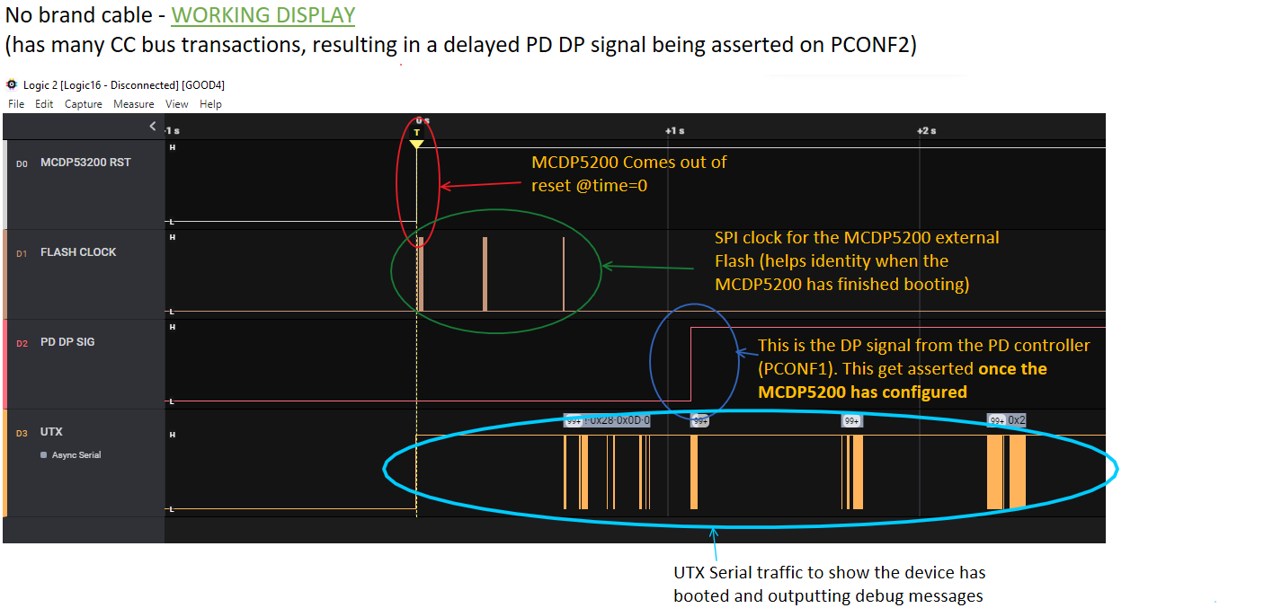

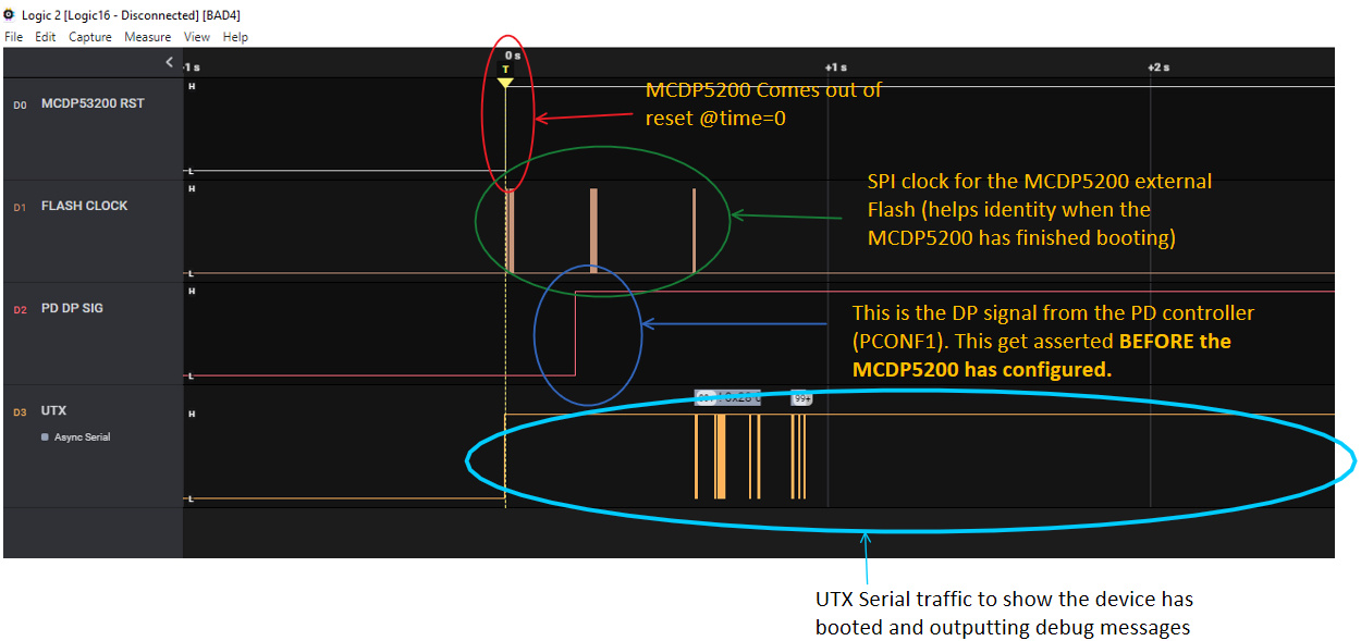

    Some good news - we've managed to find out the issue and resolve it with the help of the manufacture for the display controller (MCDP5200). For anyone else who might have a similar issue; our issues were attributed to the "DP event signal" from the DP controller setting its state earlier or later depending on the amount of CC traffic we were getting, between different cables. This results in a change of time in the DP event signal being asserted, which could be before or after the display controller had time to finish booting and loading its firmware upon power up. We managed to get some evidence to prove the MCDP5200 was looking for an edge of a signal, rather than the absolute value of the signal at power up. which makes sense; in normal operation you shouldn't need to poll this signal to assess whether to connect the display or not. The manufacture of the part was super helpful and understood the issue and sent us an updated firmware to check the state of this signal upon power up and then swap back to edge triggering on the IO signals once booted - this worked perfectly and fixed our issues. we did have two other non-ideal solutions to the issue, like holding off the DP alt mode configuration on powerup or implement some conditional checking with our on-board processor to toggle the DP Event signal pin in the event the MCDP5200 has missed it the signal. thankfully the new firmware helped!
    Here is what it looked like:
    Lindy cable - NO DISPLAY
    (Lindy cable has few CC bus transactions, resulting in an early PD DP signal being asserted on PCONF2 before the MCDP5200 has booted)
    We're still unsure why the CC traffic is greatly different between the two cables but given the amount of different cable and DFP configurations that are possible. the amount of CC traffic could change widely. So, implementing this firmware fix makes the whole system more robust.
