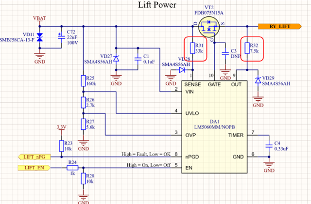

First i modified the evaluation module to resemble this:

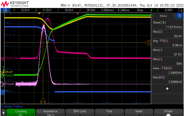

The issue i had is my load is very capacitive in nature and can generate inrush of upto 90A without including any dv/dt slow down as shown here:
Note: The yellow waveform droops in the beginning because it is powered from PSU which hits power limit at that level and reduces voltage alittle bit. For the purpose of this investigation lets ignore it for now.
As it is, the FETs are very close/slightly over it's SOA limits and so i added 4700pF capacitor for C3.

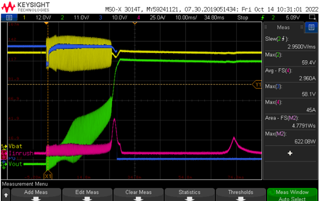

However when i did this there was a lot of ringing added into the system (although you can see inrush is reduced).
I suspected this was because of LC resonance forming on the gate line because of the added capacitance.
I added a 2.2k resistor on the line to damp this (without concern for slow turn on because the chip has constant current source). I also added a diode for reverse direction like this:
However this simply made my circuit fail instantly with the FET shorted from drain to source.
Could you help me debug this? Note adding a parallel mosfet which i need for continuous operation creates a similar issue for ringing.

    To resolve the ringing issue during startup, I would recommend you to add the following components in your circuit to help dampen the oscillations between parasitic L and C in the gate path.
    • 10Ω resistance  in the gate path of each Mosfet and
    • add 100Ω resistance  in  series with the dvdt capacitor (C3 in your circuit).

  • Hi Praveen. The solution suggested worked really well and managed to get rid of the ringing. Very much appreciated. On a similar note i had a different question.  Considering we have a load which will be on when the hotswap is turned on, and it's very highly capacitive in nature, the given controller is not perfectly suitable. With the FETS we have, we just about manage to keep it within the SOA region and for a more robust design with the given controller would need more expensive planar FETs (which usually have high rds on and therefore we would need multiple in parallel as our continuous load is a lot as well).

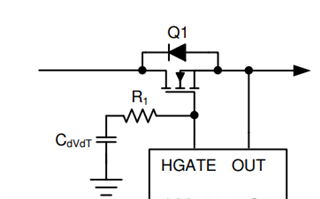

    Have you considered using dvdt (R and C from Gate to GND) circuit ? dvdt circuit will help limit the inrush current during startup and will ultimately help you to startup/charge the output capacitance while being within FET SOA.
