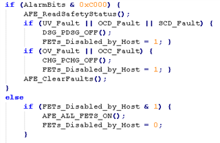

Hi Matt
Thanks for your reply.
I want to know how to control MOS only by host, when in protection the chip will not recover until host send the commands.
Star
Hello Star,
The method that Matt recommended is how you would control the MOSFETs using a host. The FETs will be triggered during a fault autonomously by the BQ76952, in order to keep the FETs off you need to send the commands described by Matt.
Then to recover the FETs manually you'd send the FETs ON command as Matt had described and shown.
