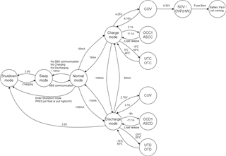

1. if our battery pack is for industrial flat panel, which software version TI recommend? R1 or R2?
2. if our battery pack wake up from shutdown mode and going to charge, does BQ40z50 has charging time out protection?
3. Would you please help to check our stat flowchart? especial we don't know how is the work flow when shutdown to wake up to normal or sleep?
Please help to provide your recommendations for us, we need your help.
Looking forward your feedback.

    From what I can tell the flow looks to be correct depending on what you program in your protections that are enabled and their thresholds.

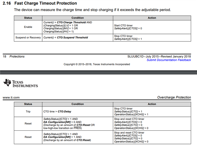

    About question 2, I mean if after charging for a long time and battery voltage didn't rise.
    Does BQ40z50 has protections for this condition?
    About question 3, customer update a new flowchart, please help to check it again.
    I sent the flowchart by message for you.

    We have charge timeout features, it is called CTO:
    I don't know all their specific thresholds but in general yes the flow chart seems correct.
