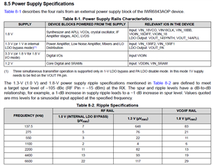

My group is developing a product based on LP87524JRNFRQ1+IWR6843AOP.
For 1.8V and 1.0V power supply, IWR6843AOP has ripple requirements as shown in the following figure.
According to the requirements in Table 8-2, the ripple of μVRMS level needs to be measured at seven frequency points.
What kind of equipment should be used and how to make the measurement?
(I have only measured mV ripples using an oscilloscope)
Thanks.
