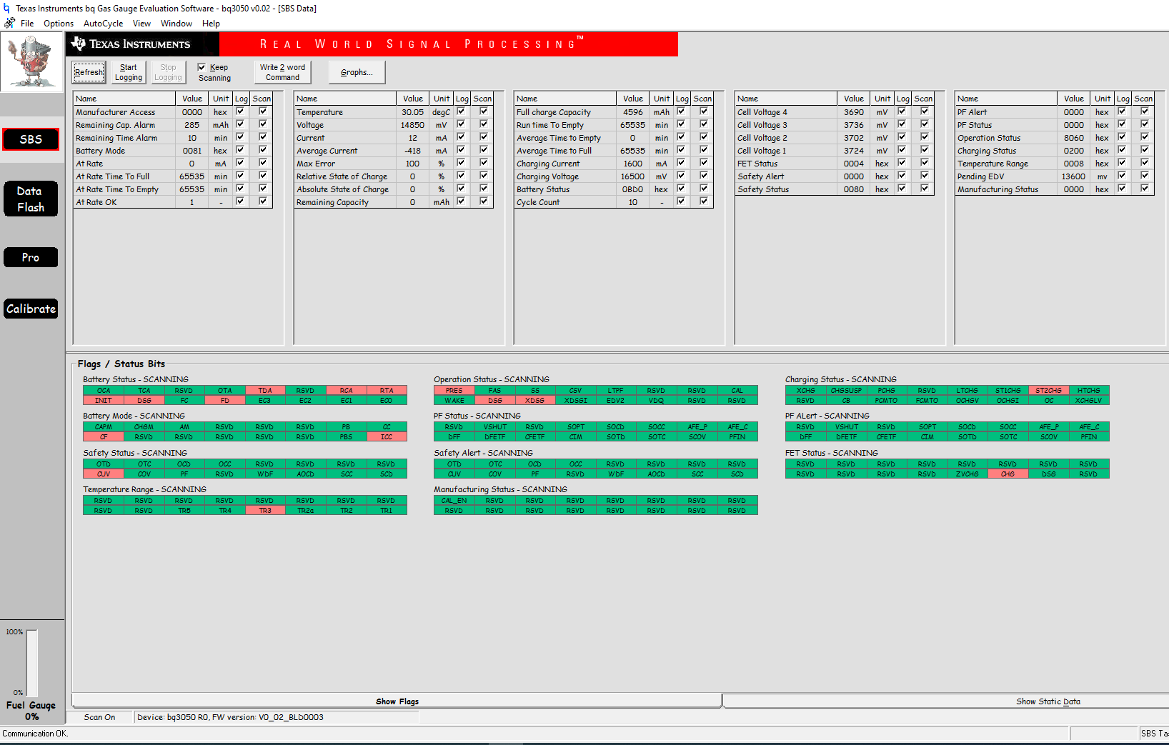

Hello Team,
I am using BQ3050EVM for our Li-on 2P4S Pack Configuration , Designed for 14.4V . Total 8 Cells.
senc file programmed and calibration is done.
I am unable to do charging and discharging with the mentioned setup.
/cfs-file/__key/communityserver-discussions-components-files/196/pastedimage1665986174043v1.png
1. Charging case SBS Config :
/cfs-file/__key/communityserver-discussions-components-files/196/pastedimage1665764053898v1.png
2. Discharging Case SBS Screen :
/cfs-file/__key/communityserver-discussions-components-files/196/4456.ErrorConnection.PNG
During Discharge , It creates CUV Condition immediately even CUV Threshold set is @ 3.38V.  We are using RESISTIVE load of around 2A for discharge.
3. No Charge / Discharge ( No Load / No Charger Connected)  SBS Screen :
/cfs-file/__key/communityserver-discussions-components-files/196/pastedimage1665986348772v1.png
  • Hello Bhupendra,
    The load must be connected to Pack+ and Pack -, not to Battery
    Same with charger.
    Also make sure that the current reading is shown correctly, otherwise it is an indication that something is not connected correctly

    While Discharging it Takes around 1.9A for just sec and goes into CUV Condition , disabling FET to stop discharge. ( Strange,  CUV Condition occurs without crossing Cell CUV threshold   ).
    IF I connect 4P to PACK+ and 1N to PACK-  ( YELLOW Connector in setup ) then Everything works fine.
  • Hello Bhupendra,
    Connecting 4P to PACK+ will bypass the FET. Once CUV is triggered, I would check the actual voltages on each of the cells and see if any of them are below CUV threshold. You may need to bypass FET to check this because the voltage will recover quickly after CUV. Bypassing the FET will prevent recovery and allow you enough time to measure.
  • Hello Shirish,
    We checked the Voltage on Every Cell while connecting Load and @ No Load Condition.  Cell voltage are fine and same as we read on BQEVSW Software.
    Not able to understand why CUV happens before CUV threshold ?

  • Hello Bhupendra,
    Can you send a SBS log from bqEVSW when you get into CUV condition? System present must be active when a load is connected.
  • Hello Shirish,
    CUV Condition Remains always. Either Load / Charger is connected OR not connected. Charger is not able to charge as Battery is not detected due to CUV condition ( Discharge FET OFF).

  • To Remove CUV Condition , Tried Charging Battery by connecting 4P and 1N directly to the charger , and charged upto the state where FD is cleared and FC is Set. There may be some glitches , but ignore it as i have some connection trials.
    See the Charge Log :  /cfs-file/__key/communityserver-discussions-components-files/196/ChargeSBSLog.log
    Then Charger Removed ,4P & 1N connection Removed from PACK+/PACK-  , and 2A RES Load is connected to PACK terminals to create CUV Condition . after connecting LOAD in few Seconds , CUV Condition Occurs.  NSee the Discharge Log : /cfs-file/__key/communityserver-discussions-components-files/196/DischargeSBSLog.log
    One Point I noticed here is : In Both the cases Charge / Discharge condition Current values appears wrong on BQEVSW application compared to Ammeter. Actual DisCharging current was 2A but was showing 4.8A.
  • Hello Bhupendra,
    The discharge and charge voltages do not match.
    The logging interval is set to 35 seconds. The default of 4 seconds will capture the condition much better. I would set it to 1s if the CUV condition is seen within 10 seconds
  • The discharge and charge voltages do not match.
    Pls, Can you elaborate this ?
    Once again i repeated the steps and here is Discharge Cycle Log with 1 Sec interval. Same setup. Then Connecting 2A Load. ( also i have done Current recalibration this time ). Surprisingly , CUV Worked this. VDQ was set at this time. here is the Log File.
     /cfs-file/__key/communityserver-discussions-components-files/196/5127.DischargeSBSLog.log
      One Point I notice here is : Cell balancing , after connecting Load we see 400mV Difference between Cell1-4 to Cell 2-3.   upon CUV Condition all cell voltage seems align.
  • Log shows that the gauge is operating correctly. The CUV threshold is set at 3.38. Gauge CellV1 drops to 3376mV on line 53 which is below the threshold. The next line shows that CUV has been triggered.
    Your cells are out of balance and are causing the problem. The protection is kicking in to protect the cells from over discharge.

  • Hello Bhupendra,
    Cell balancing is active only during charging. You will need to charge until it balances. There is a limit to how much balancing is possible based on how much current passes through the bleed FETs. It is normal for large imbalances to cause such issues. Are these old cells?
  • Thanks shirish,
    Cell are very much new. Just One month Back purchase.
    I think It may be because of Higher discharge LOAD current (>= 2.1A).  Should I change those 2 Cells which has Higher imbalances ?
  • Hello Bhupendra,
    The cells have an impedance mismatch. The log shows  cells are voltage balanced when there is no load. You should use matched cells. I would recommend starting with all new cells instead of just replacing 2.
