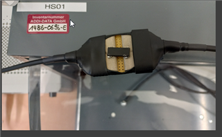

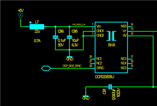

    May I bother you to share a photo picture of your setup, when you test the DCP020505 device standalone, or on your circuit board?  I would like to see how the Hotpot instrument is hooked up to the device in standalone or soldered on your circuit board.
    By the way, the 500V/s slew rate is the maximum limit for the flash test and the actual setup should take a slower slew rate,
    Youhao
  • Hi Youhao
    this is our " adapter"  for the test of the component
    this is the board with 1* DCP020505U and 2 DCP020515DU, the red line shows the isolation barrier with > 3.2mm distance for 1000V, we only test with 500V DC
    Regards Achim
  • Hi Achim,
    Thank you for the info.  I can see that the 0.047uF capacitors across the isolation boundary are installed.  These capacitors will also draw current when you apply the HV voltage at a slew rate.
    3x 0.047uF x 500 V/s = 71 uA
    Therefore, the 60uA limit setting on the tester is not enough.
