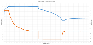

I have the BMS 6S design with BQ40Z80 IC and BAK N18650CP Lithium-ion Rechargeable Cell. I created charge/discharge profile based on "Simple Guide to Chemical ID Selection Tool (GPC)" document. I received GPC report with ChemID -> 5829 as a best chemical ID but this ID is not exist on the bqStudio chemical ID list. In the received report I see note that "Deviation is above recommended level. New chem ID needs to be released for this cell. Please contact your TI representative to send the cell to Dallas for characterization". Can you help me with this issue?
Profile of my Li-ion cell on picture below. As you can see in the discharge mode I used CV discharging option (2.5V) on my load. Do you think that this is a reason of the problem with ChemID selection?

  • Hello Kamil,
    It is possible the CV discharge caused the tool have some larger errors since it is expecting a constant current discharge until terminate voltage where it should immediately stop. Please try to test with only constant current discharge and stop discharge at terminate, this should improve the tools results.

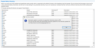

    I have updated chemistry list in bqstudio to version 992 but I cannot to find ID 5829. Please see the attached pictures.

    Make sure you click the checkbox at the top of the table to include chem IDs that don't contain turbo mode support. Most applications do not require turbo mode data so there are a lot more chem IDs available without turbo mode support.

  • Hello Wyatt,
    I found my BAK N18650CP cell as ID 5267 in database version 992 with enabled "include chemistry IDs that do not support Turbo mode 2". This is good information. Now we can start to preparing the golden image for our BMS.

    And additional information:
    We repeated charging/dischaging profile without CV in discharging mode as you can see on the picture below but GPC report still shows ID 5829 as best chemical ID for BAK N18650CP. This is very interesting what is the reason of this. I will be grateful for any information. In atachement you can find our data from measurement.
