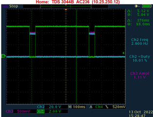

  • Hello Mason,
    1. Yes, of course. Can it accept 10us ?
    2. In fact, I have realized that there is always a delay between the time I trigger off the transistor Q4 and the time the current appears in the LEDs (x to 230us). This delay varies all the time. Why is it not constant and what is it minimum value ?
    Richard
  • Please, kindly watch the video to see how the delay varie.
    Legend :
    Green signal : The Q4 trigger
    Blue signal : Voltage in the LED
    Purple signal : Current in the LED

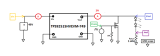

  • hi Richard
    would you mind sharing your schematic first?
    so, the operation condition is: Vin=45V, VLED=?, ILED=1A, what is the dimming frequency of VCOM?
  • Hello Mason,
    Here is my circuit.
    Note I'm still testing the evaluation board. So the only addition circuit is my transistor and the 10k resistor.

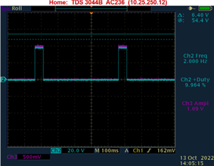

  • hello Richard
    thanks for the information. But do you mind sharing VLED (waveform shows ~40V, pls confirm ) and dimming frequency?
    Besides, can you also add SW together with original signals in both Q4 on period and Q4 off period. I would like to see the whole time period view. thanks
  • Hello Mason,
    I'm sorry for the delay. You asked it before, but I forgot.
    Here are the signals:
    Vin = 45V
    VLED = 34V (12 LEDs in series)
    VtriggerQ4max = 5V
    freq_triggerQ4 = 2Hz
    Duty cycle VgateQ4 =  90%
    So Duty cycle_VLED = 10% (since signal is inverted at the drain of Q4).
    (See messages above for the legend)
  • Just to add that when you put all the curves together, you dont see the delay. It is whwn you zoom on the trigger time that you see the delay of the voltage and that of the current.
    Richard

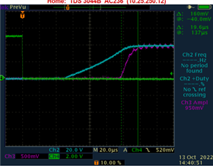

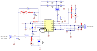

  • hello Richard
    as I mentioned, is it available to capture SW waveform together with other signals shown below?
    Besides, for shunt dimming, it is necessary to derive the OFF-time ramp from an alternate source. When the output is shunted, the output voltage becomes very low and possibly less than the 1 V OFF-timer threshold voltage. If this occurs, the off timer is not able to trip and the OFF-time reaches the maximum OFF-time before the switch is turned on again. this may cause some uncertainty when Q4 trigger on. more detailed information, pls refer to 8.3.4 in datasheet.
  • Hello Mason,
    Kindly find in the figure below, the signal VSW (in yellow).
    Richard
  • hello Richard
    thanks for your information.
    According to the waveform above, when Q4 is triggered on, the SW is clamped to min. on time due to output voltage is shunted zero volt. This means during this period of time, inductor current is quite small and additional start-up time is needed when Q4 is triggered off and LED current rises.
     I think add alternative source mentioned in last reply will help reduce start-up time as it will let inductor current still maintains in the target current value when Q4 is triggered on.
