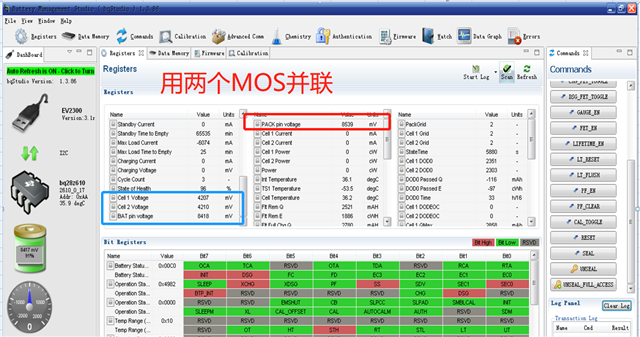

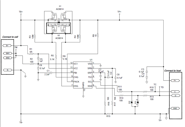

Hi
I have a query need your help.

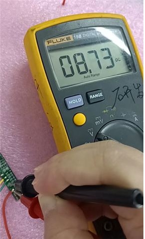

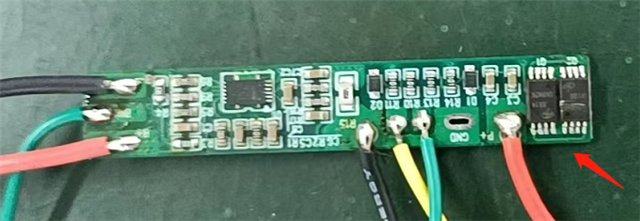

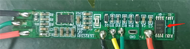

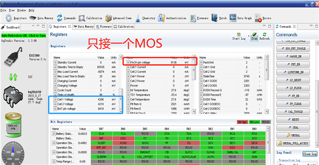

When use one MOS in the schematic the pack voltage is the same with FLUKE measured.
When parallel one MOS, the pack voltage is 8.539V, FLUKE measured the voltage is 8.8V and unstable.

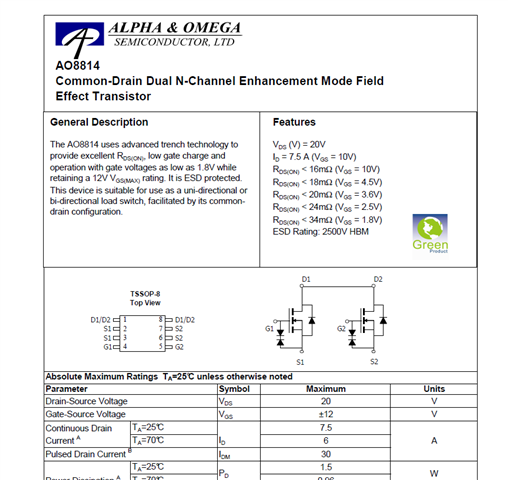

Attached the schematic and MOS SPEC
Why parallel one MOS the voltage is abnormal?
Waiting for your reply.
Star
  • Hello Star,
    Usually it is only two N-Channel MOSFET in series back to back. I have never seen a design with parallel MOSFETs. Any particular reason for this?
    Parallel MOSFETs can cause imbalance in current during switching transitions if the wiring  layout of each MOSFETs are not identical. This can increase power losses.

  • Hi Jose
    Thanks for your help.
    One MOS does not satisfy the working current, so they parallel one MOS.

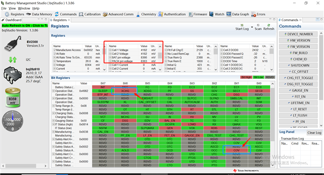

    The query is why the output voltage incorrect after overcharge protection.

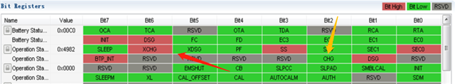

  • Hello Star,
    From the pictures above, I can only see few responses from the gauge. Do you have a log file which describes this scenario?
    I have couple of questions, from the schematic above I do not see any protector. If no protection is being used in the schematic, did you disable the protections under Settings: Enable Protections A and Settings:Enable Protections B?
    Can you share the log and gg file?

  • Hello Star,
    From gg file, I can see that Overcurrent in Charge protection is enabled. From the above schematic, I do not see any protector. This is a problem, the gauge will act as if protectors are part of the system.
    I suggest disabling the Overcurrent In Charge Protection if not protection is being used, or even disabling protections if not used at all. Or, increasing OCC:Threshold if current is greater than this threshold.
    I will need a log file to provide more details, but essentially if the current is greater than OCC:Threshold for OCC:Delay duration, this will trigger Overcurrent in Charge Protection.

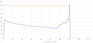

  • Hi Jose
    Attached the screenshot and log data.

    From screenshot the battery pack voltage is 8363mV and in COV protection, but the multimeter measure the voltage is 8.73V.
    Star
  • Hello Star,
    Looking at the log file, I see the gauge is working as expected. When Charge FET turns off (due to COV), the current sensed by the gauge at BAT side immediately drops to zero. The gauge is doing what is supposed to do. Please see below
    The gauge uses Voltage sensed at V-Bat side to preform its gauging algorithm. So, I don't think this will cause any issues as for the gauging aspect. Please see below.
    Looking at the image above, I see that V-Pack is stable until COV. At COV event, the gauge opens the CHG FET and no charging current is allowed. This is what is expected from the gauge point of view. Any measurement after COV is not relevant as the gauge will ignore this.
    Notice how Vpack is bouncing up and down, this is the reason why your FLUKE measurement is different from what the gauge reports.
    Have you tried measuring VPACK before COV? It looks like VPACK is very stable before COV.
    I would also double check the parallel FET connections. Please read the below app notes which reference to parallel FET applications.
    https://www.ti.com/lit/an/sluaa09a/sluaa09a.pdf?ts=1666972968324&ref_url=https%253A%252F%252Fwww.ti.com%252Fproduct%252FBQ76952
    https://www.ti.com/lit/an/slva729a/slva729a.pdf?ts=1666973248359&ref_url=https%253A%252F%252Fwww.ti.com%252Fproduct%252FBQ76200
